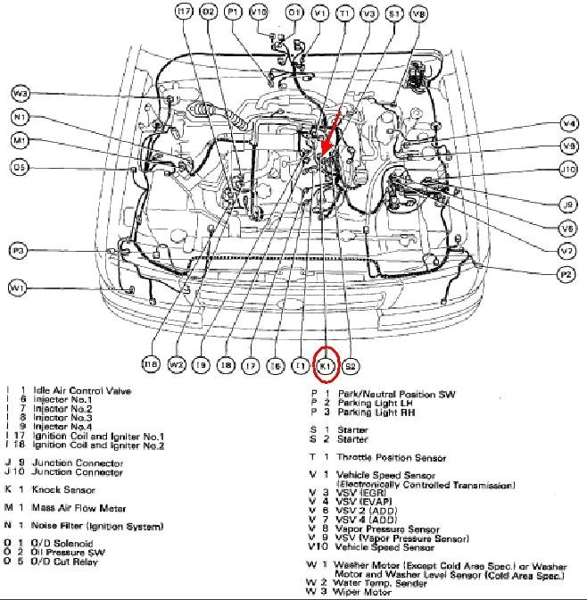

Poor gas mileage and lack of power when po325 shows.

Given the mileage, a good suspect is a stretched timing chain. That will cause low power, and if it is slapping against the housing, the knock sensor will pick that up as spark knock. You can see this on a scanner as the engine computer keeps retarding spark timing, or the timing is bouncing around.

could you tell me the location of the knock sensor?
Jan 29, 2018 at 4:00 PM
CARADIODOC
  • 34,308 POSTS
Hope you can read this. It gets too blurry if I try to expand it too much.
