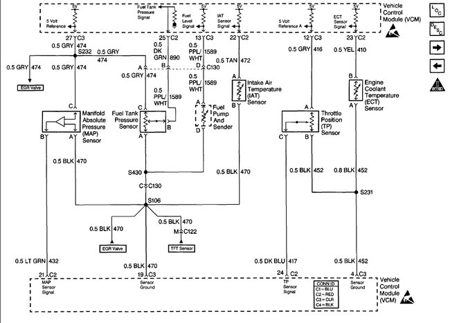

I replaced the fuel pump and shortly after I have been having issues with the DTC code P0452. I have replaced the fuel pressure sensor and still have the code P0452. Would like to know what else could be causing this code electrical or other wise? What should I be testing in next?

Did you clear the code after replacing the fuel tank pressure sensor?
If not, do so and if you did follow this test procedure.

I did clear the code, I started the processes of running the diagnostic, however I don't own a scan tool that allows me to do some of the test, so I am using a DMM. I am not sure how to test a short to ground. On step 5 I have the 5V reference. As I tested the jumper wires I got a 4.98V reference. I went to step 11 and it states to test short to ground. Not quit sure how to do that.
Monday, January 22nd, 2018 AT 12:05 PM
PATENTED_REPAIR_PRO
  • 1,853 POSTS
Place one test lead of the ohmmeter on the fuel pressure sensor signal wire and the other test lead on a metal ground and check if that wire is grounded or showing continuity to ground. It should read infinite.

Do you know which wire will be the wire for this circuit at the VCM?
Thursday, January 25th, 2018 AT 2:53 PM
PATENTED_REPAIR_PRO
  • 1,853 POSTS
It should be a dark green wire at connector 2/pin 25.
Here is the wiring diagram.

I went through the troubleshooting guide you provided. In step 4 it states I should have almost 5.0 volts for the reference line. I have 5.0 volts if I use the ground on the wire harness and 5.2 volts if I use the ground at the frame. Do I have a problem with to much of a reference voltage or is this normal for this type of vehicle?
Monday, January 29th, 2018 AT 11:28 AM
PATENTED_REPAIR_PRO
  • 1,853 POSTS
5.2 volts is about 5 volts so, If voltage reading is about 5 volts, go to next step.

So in retracing my steps the signal wire in step 5 has 2.22V, I then went to step 11 and it shows OL. Now I move to the VCM, 12. Check fuel pressure sensor signal terminal connection at VCM. If problem is found, go to step 15. If terminal connection is okay, go to step 16. In this step am I only looking for the connectors, to make sure they are not loose or do I need to check voltage?
Monday, January 29th, 2018 AT 11:58 AM
PATENTED_REPAIR_PRO
  • 1,853 POSTS
If the result for step 11 is ol, or in other words infinity that is ok, meaning that wire isn't shorted to ground. So, go to the next step 12.

Replaced the VCM and still have the same issue. I acquired a short finder tool and will be looking for the short this week. Is it possible to get a wire diagram for the fuel pump, I replace the pigtail and no longer have the wiring instructions. I need to make sure I have it wired properly? I know the fuel pump and the fuel tank pressure sensor are on the same circuit. Need to narrow down my search parameter. Thanks
Sunday, April 8th, 2018 AT 7:37 PM
PATENTED_REPAIR_PRO
  • 1,853 POSTS
I think you should repeat the steps again and let me know the results of all them steps beginning with the result from step 12, cause I assume you went to step 16 right after 12.
Monday, April 9th, 2018 AT 7:38 AM
BCMULLEN95
  • 249 POSTS
Repeated all the steps, found out that where the wire harness bunches up under the hood the green wire coming from the VCM to the 4 pin connector the wire was shorted. Ran a new wire from the computer to the sensor and have no returning code. Thank you for your help.
