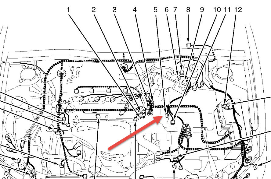

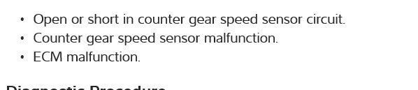

Transmission seems sluggish
Tuesday, August 30th, 2016 AT 1:43 PM
HMAC300
MECHANIC
48,601 POSTS
See pics for problems with this code. It could be a speed sensor bad
