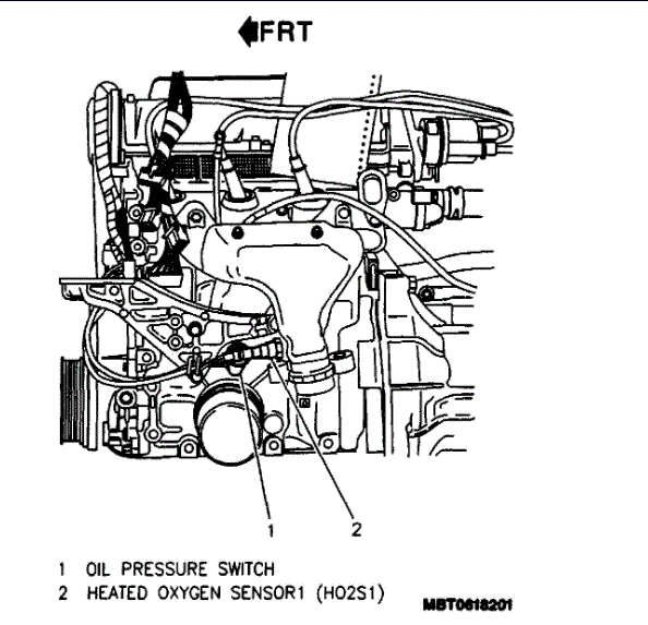

Good morning,
Most of the time it is the O2 sensor for this but must be confirmed.
https://www.2carpros.com/articles/how-an-oxygen-sensor-works
https://www.2carpros.com/articles/how-to-replace-an-oxygen-sensor

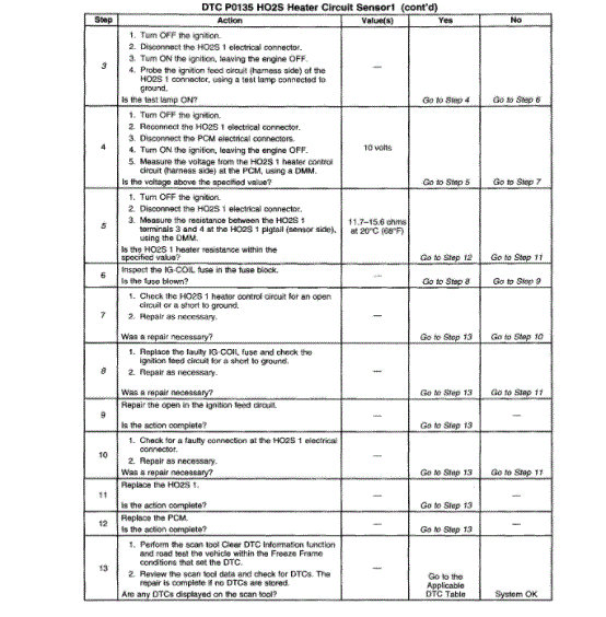

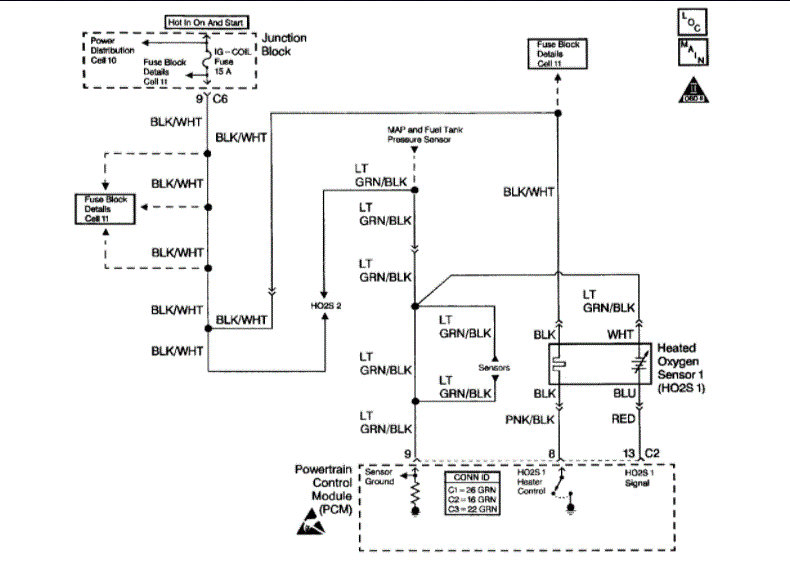

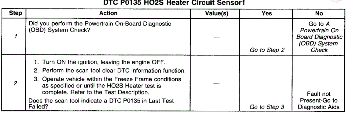

I attached the description and the flow chart for you to follow to determine the failure.

Test Description
The numbers below refer to the step numbers in the Diagnostic Table.
1. The Power-train OBD System Check prompts the technician to complete some basic checks and store the freeze frame data on the scan tool if applicable. This creates an electronic copy of the data taken when the fault occurred. The information is then stored in the scan tool for later reference.
2. This step checks whether the malfunction that caused the DTC P0135 is still present. Driving the vehicle under these conditions will verify that the fault is present. The DTC P0135 diagnostic can be monitored on the scan tool under the MIL/System Status selection of System Information. When the HO2S test displays a YES status (indicating that the purge system diagnostic is completed) check for a DTC P0135 in the Last Test Failed screen of the scan tool. If there is no DTC P0135 displayed the HO2S system diagnostic has run and passed, indicating that no malfunction was present this time. DTCs must be cleared in order to view the current status of the system diagnostics being performed. Do not forget that the MIL/System Status tests only indicate that the test has run, not whether the test passed or failed. The Last Test Failed screen must be checked for related DTCs in order to determine the outcome of the diagnostic test involved.
3. The HO2S 1 heater is powered by the IG-COIL fuse located in the Junction Block.
5. This step measures the resistance of the heater circuit of the HO2S 1.
8. This step checks for a short to ground in the HO2S 1 heater circuit. If no problem is found in the HO2S 1 heater circuit the problem could be a faulty (shorted) HO2S 1.
