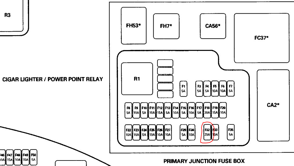

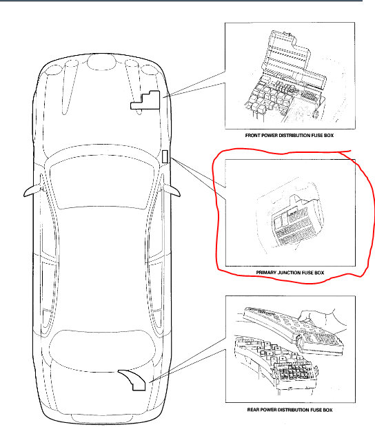

Where is the fuse located so I can replace it?
Tuesday, December 17th, 2019 AT 2:49 AM
DANNY L
MECHANIC
5,648 POSTS
Hello, I'm Danny.
It is located in the passenger side fuse bow. The fuse is a yellow 20 amp fuse and located in position #32. I've attached pictures below and circled in red on the locations for your vehicle. Hope this helps and thanks for using 2CarPros.
