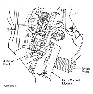

BMRFIXIT
  • 19,053 POSTS
Ignition switch is very common failure too but 1st try to:
Disconnect BCM wiring connector wait few min and reconnected
check if its start
https://www.2carpros.com/forum/automotive_pictures/99387_Graphic1_619.jpg
