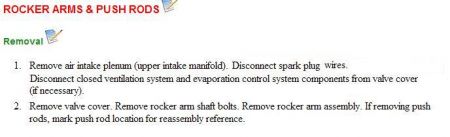

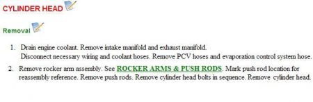

cant get the head off. The timing belt and cover seem to be holding me in. Do I need to put the engine on jacks

Does this help?..
