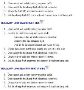

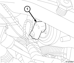

how to change a head liight
Friday, January 2nd, 2009 AT 7:10 PM
ZACKMAN
  • 4,202 POSTS
https://www.2carpros.com/forum/automotive_pictures/55316_07sebringheadlight_1.jpg
https://www.2carpros.com/forum/automotive_pictures/55316_07sebringlight_1.png
