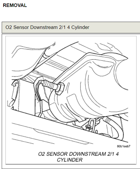

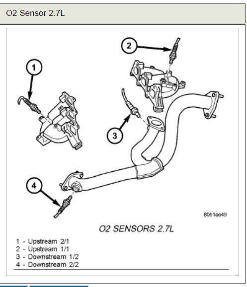

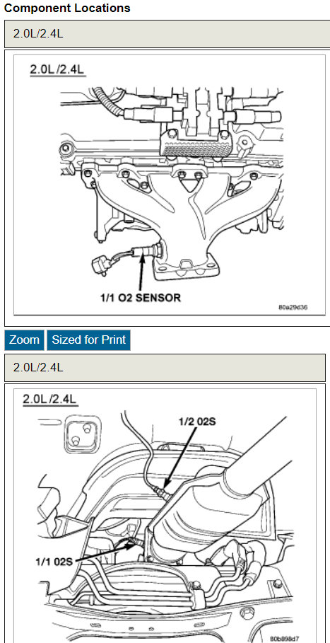

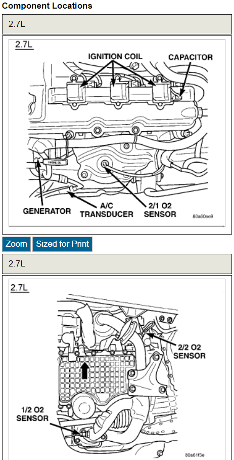

Hi, I have a check engine light for an o2 sensor high voltage on Bank 2 Sensor 2 and am just trying to figure out which side of the engine the bank 2 is. I know that sensor 2 is the one after the cat but don't know which side is bank 2. Thanks for any help.
Sep 29, 2009 at 4:51 PM
BLUELIGHTNIN6
  • 16,542 POSTS
Here is a guide that will show you what you are in for when doing the job.
https://www.2carpros.com/articles/how-to-replace-an-oxygen-sensor
Here are the locations of the oxygen sensors (below) I have both 4 and 6 cylinder engines just in case.

It was a snap thanks for your help I love this site. :)
