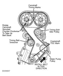

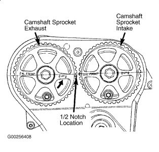

need to know the points to set the timing belt

Hello
i will need the 8th digit of your VIN to provide the correct info. Requested.
It should be either G, B, or X.
Thanks for using 2CarPros. Com!

It is an X. We need the markings to set the belt.
