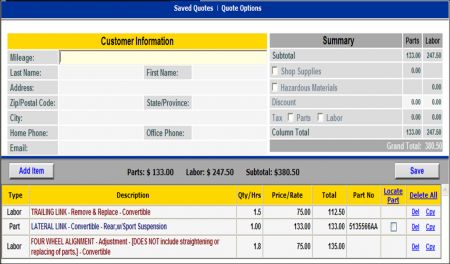

My car is, in fact, a Convertible; VIN 1C3EL55R.
The mechanic tells me that the newer models have a different set up for the "rear lateral adjustment link" -- to replace mine, he wants to charge $320. That's quite a chunk of money and that's why I wanted to do some research before I get this done.

Thanks for the info. . ..I can give you a little more info. I have attached what I came up with for a rough quote. . ...again. . ...rough. As you see, mine is a little higher. . .. . .depends on the area etc. . ..but this should give you an idea that he is close.
My suggestion. . ...replace the other one. You have to get the alignment anyway. . ...but I kind of do certain things for "preventative" maintenance. I don't want to go back repay for an alignment when I find out the other went bad. Just a thought
Yes, a chuck of money. . .. . .Look it over, maybe you could replace the parts and just pay for the alignment.
