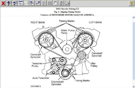

2002 CHRYSLER SEBRING
Looking to find out the exact timing marks on the cam and crank and what way they line up
