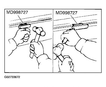

how do i change my oil pan and is it force to change the oil pan gasket?

After removing the oil pan mounting screws u may need to use a bras straight edge and a hammer to remove the pan because they use silicone as a gasket

https://images.2carpros.com/forum/automotive_pictures/99387_oil_pan_1.jpg
