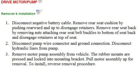

The motor that raises and lowers the convt. Top has sounded strained for weeks and has finally just about died. I wish to replace motor, need instructions to do so with pictures of removing the back seat for access and any additional tips. Thanks, Linda Aldirch

https://www.2carpros.com/forum/automotive_pictures/55316_99sebringconvertible_1.jpg
For better instruction with illustrations, you may want to invest on a Haynes or Chilton manual, available from your local parts store.
