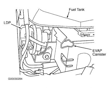

Would You know what this is that is not working or needs replaced?

DTC P0442 : EVAP Leak Monitor Medium (.040) Leak Detected
This code is most commonly set because of a loose or faulty gas cap.

We replaced that, any ideas!

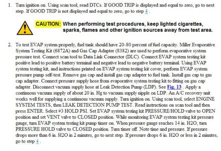

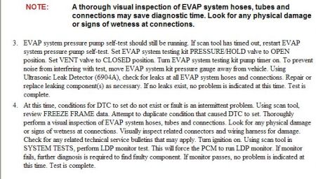

There are alot of EVAP components that could cause a small leak like this. Perhaps the diagnostic steps below will help you pinpoint the leak.
