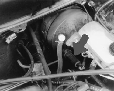

I have 94 Lhs and there is a sensor in the brake booster that is leaking air in around it.The sensor kinda looks like a little shock and is spring loaded when removed and has electrical plug on it.My parts store can't seem to find this part in there system.Anyone know what this sensor is called?...My brakes are hard to push because the booster is sucking to much air in around the sensor.[img:913714aa7a]http://www.2carpros.com/forum/automotive_pictures/199886_sensor_1.jpg[/img:913714aa7a]

On any model there must be(by Federal Law) a diagram on the underside of the hood, it is to the right as you look up with the hood open, it's to tell any technician how the routing should be so emissions don't get screwed up. This valve is a small vacuum resevoir used as a way to supply an accessory with enough vacuum so that large changes on acceleration going up hills doesn't deplete all the vacuum. It will be labeled on the diagram, use some black RTV silicone to seal it, let it sit overnight, RTV seals almost everything, especially your fingers to your hands. I could be wrong, it was normally not used but 94 was a year still developing the LH model.
