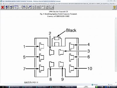

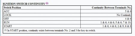

Starter Remains Engaged When Ignition Switch Is Turned On?
Monday, January 14th, 2008 AT 9:05 AM
MERLIN2021
MECHANIC
17,250 POSTS
You will need to check continuity of the switch...if key is On, not crank, and there is cont. to 6 and 8 replace switch...if no cont. replace starter.
