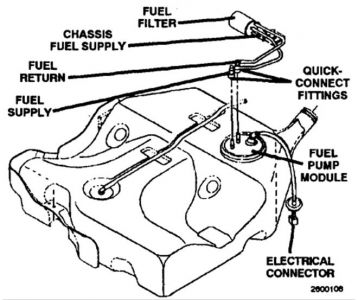

Where is the fuel filter and fuel pump located?
Saturday, May 8th, 2010 AT 3:50 PM
MECHANIC
75,992 POSTS

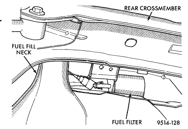

The fuel filter mounts to the frame above the rear of the fuel tank. The inlet and outlet tubes are permanently attached to the filter.
Fuel pump location:
