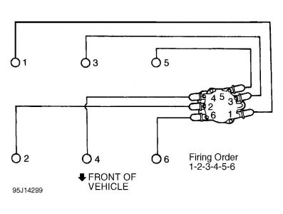

Where are the 6 spark plugs located in my 1996 Chrysler Cirrus located? Thanks!

On top under the manifold
just follow spark plug wires to the plugs
https://www.2carpros.com/forum/automotive_pictures/99387_chry_cirus_1.jpg

To access the back three plugs you have to remove the upper intake manifold. You will have several plugs on both sides of the manifold to disconnect three vaccum lines to take off. When all is disconnected loosen the bolts on top of them a little at a time crisscrossing bolts until you can loosen by hand. Remember where everything connects too and install in reverse order. Tighten bolts in criss cross pattern and do not over tourqe. The gasket is metal and should be able to reuse it it you do not bend or damage it.
