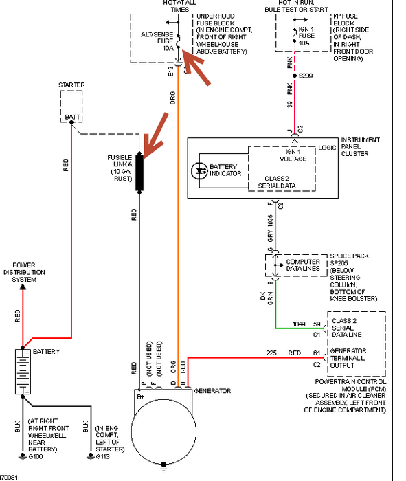

Replaced alternator & battery. Battery light still comes on and fan/heater blows normal then slow. What could issue be?
Thursday, November 26th, 2020 AT 7:54 AM (Merged)

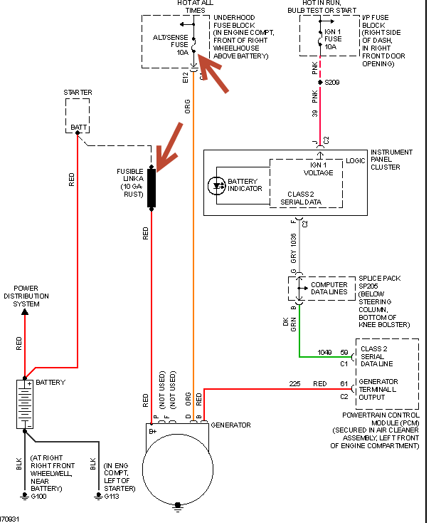

HMAC300
  • 48,601 POSTS
There is a fusible link for alternator thatcould be partially broken or ready to go causing this. There is also a fuse in underhood fuse box i've pointed bothout in arrows, check those.
FREEMBA
  • 1,152 POSTS
Also, you should check the connections at the alternator and battery. A loose connection can cause this.
03VENTURE
  • 2003 CHEVROLET VENTURE
Our battery light was coming on and off and on again. Volt meter tested around 1200 so we replaced the alternator. But now the battery light wont go off. Battery was replaced in 11/07.
Can you please help?
Thanks
+1
Thursday, November 26th, 2020 AT 7:55 AM (Merged)
  • 75,992 POSTS
Could be a problem with the computer controlled field generation circuit-see below
https://www.2carpros.com/forum/automotive_pictures/12900_field_1.jpg
+3
03VENTURE
I think your on the something. The circuit seems bad and had no current. Now I gotta find which wire that is.
Please let me know if you have any more ideas or suggestions.
Thanks.
Maria
03VENTURE
HOT DANG! Thats it! Fuse is ok, it was a Bad wire.
Alright, Now I just gotta replace the wire.
Good grief, and all that after replacing the altenator.
Thanks so much!
