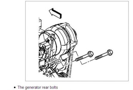

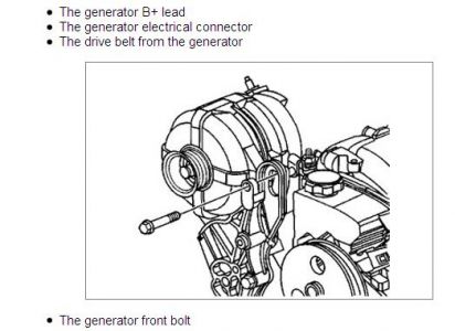

Where are all the bolts located on the alternator to take it out?
