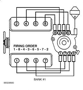

what is the fireing order on the distributor cap and ware is #1

Need engine size
Tuesday, September 15th, 2009 AT 2:19 PM
PAUL FINCHER
MEMBER
2 POSTS
It's a 5.7 L

Hope this helps
