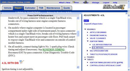

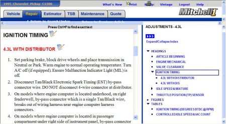

How do you set the timing
Thursday, January 8th, 2009 AT 9:52 AM
MECHANIC
75,992 POSTS
See below
