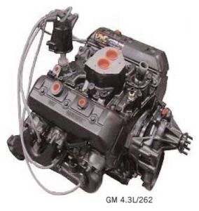

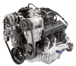

I am sorry to say the manual doesn't show any pics like you probably need. Does your engine look like one below?
https://www.2carpros.com/forum/automotive_pictures/248015_chevy_v6_43262_1.jpg
https://www.2carpros.com/forum/automotive_pictures/248015_GM262gasengine_1.jpg
Most likely the plug may have blown totally out. Hopefully the threads in the head are not damaged.
When was your last tune up. . ...plugs. . ..wires etc??
Look on the sides of the heads near the exhaust manifold for the plug or the hole. . .. . ...use a strong light.
If it did blow the plug out I would CAREFULLY ease a new plug in to see how the threads took it.
What is the 8th digit of your VIN
Please let me know what you find and if one of these pics help

Thanks for the quick reply. As far as I can tell, that is the correct engine in the photos. I was wondering if the spark plug blow out was the problem, being that I can't see the plug. I plan on checking it in the morning when I can actually see. Since you say it could be a blow out, it is it possible that the hissing tapping noise I had heard before was air seeping out around the spark plug (because the plug was loose) Then when I pulled in the drive way and it started popping because it had finally pushed the plug completely out? (The load popping didn't start until I got home) I wonder if there is a spark plug on the ground somewhere. I changed my distributor cap last year, and the wires were changed I believe in 06. I will go ahead and change all the plugs. I just have to find where that last one is. I just hope it isn't anything serious. I usually fix the truck myself because I can figure stuff out pretty easy, Hopefully this one will be the same. The 8th number in my VIN is "Z"

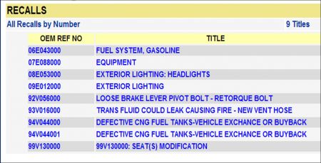

Also, it looks like you may have some recalls on your vehicle. The dealer may fix these for free. Please contact the dealer service department, give them the VIN number of your car and have them check on these to see if they apply to you.
