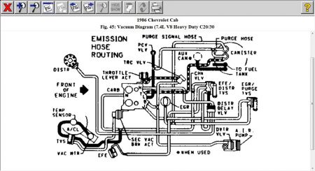

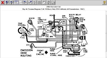

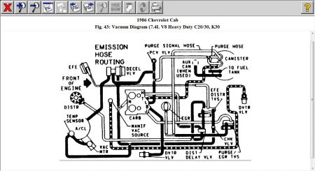

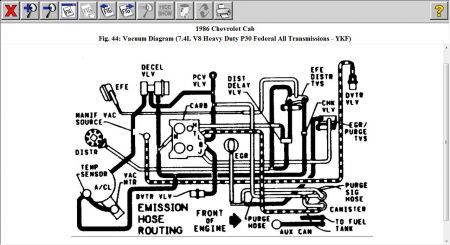

I need a diagram of the vacuum lines for emission control. I have a 454 in a 1986 RV, and live in California. There was an excellent diagram "Posted at Mon Aug 24, 2009 9:46 am

Try matching it with below vac diagrams, meanwhile I'll get with docfix-let me know if its the right diagrams. For manuals go to: https://www.2carpros.com/manuals.php
https://www.2carpros.com/forum/automotive_pictures/12900_454a_1.jpg
https://www.2carpros.com/forum/automotive_pictures/12900_454b_1.jpg
https://www.2carpros.com/forum/automotive_pictures/12900_454c_1.jpg
https://www.2carpros.com/forum/automotive_pictures/12900_454d_1.jpg

The Heavy Duty P30 California All Transmissions looks to be the right diagram.
