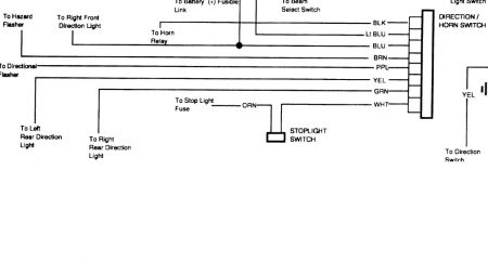

I have tested the socket for my left rear turn signal/break light/running lights "1157 bulb". The bulb itself is good, i read 12volts to ground on brown wire "running light" and intermittent signal on the yellow wire. I assume there is a short in the line from somewhere from the steering column to the socket. I have stripped wire bare and tested just outside the socket to make sure it wasn't the socket itself. Any suggestions to where i should concentrate?

With turn signal on, there would be a pulse on yellow wire. Maybe I didn't understand your question? There shouldn't be any voltage on the brown wire unless the headlamp switch is turned on. With a faulty ground, the turn signal might try to use the brown wire for ground?

I checked the brown wire to ground to make sure there was no fault in the socket with parking lights on.
I checked the yellow wire both with brake pedal and turn signal on. I would get a reading of 1.5 volts before it would go to zero but no steady reading. I checked the brake light because i knew it would be a steady voltage with no flash because it runs on the same yellow line.
Since the yellow line is tied to both the break switch and the turn signal/flasher relay there is a short after leaving the flasher. My front flasher works, but read doesn't.
I was asking if there would be a possible place to look for short without having to tear out whole line or should i just run a new line for the yellow wire after the flasher relay.

I don't hunt the short on a single circuit, I cut the wire on both ends and splice in a new wire.
https://images.2carpros.com/forum/automotive_pictures/170934_chevy_truck_ts_1.jpg
