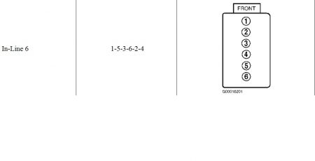

I changed the plugs and the boots because it had 160,000 miles now the car runs ruff. It has no power and sounds like it is missing

Is this a 4.2 inline 6? Did you get the firing order correct? Did you use oem plugs? Ac 41-965
The picture is for an inline 6.
