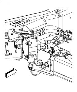

Check engine light (po179)comes on intermittently, but stays on longer at times. I cant find anything on how to diagnose this code(FUEL COMPOSITION SENSOR). Where is this sensor located.

FCS measures amount of ethanol in fuel. Must have a diagnostic scan tool to diagnose so trip to shop is needed. Located on frame need to remove transfere cover shield to acess.
https://www.2carpros.com/forum/automotive_pictures/198357_Graphic_441.jpg
