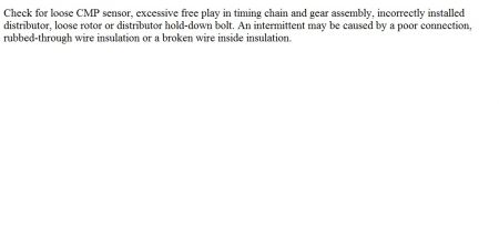

Tahoe is running fine but I have a service engine soon light on reading 1345.

The computer thinks the cam and crank sensors are not in sync.
