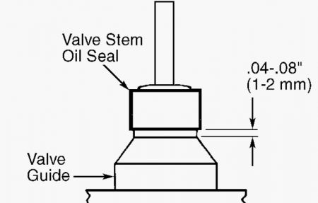

You followed the directions on the head gasket? Some need sealnt applied, most do not. Did you use a chemical decarbon solution on the pistons? And some require a sealant on some of the head bolts? Some want light oil, some dry, and this will make a hugh difference in the torque! Try pulling 3 and 5 plugs again and check em out. I sent you a PDF on installing the heads, read it and see if this is how you did the job, check email! Did you install new valve stem seals? This is the proper way...
http://www.2carpros.com/forum/automotive_pictures/62217_tahoeguides_1.jpg

Thanks again merlin for all your help. I did follow instructions for putting head gasket on. I have since taken head back off, sent it to a better shop. No cracks, good. They think that #3 exhaust valve may not be seating centered. Gonna do seats, valve grind, check for cracks, pressure test, send it back to me. Meantime, i'm gonna pull the other head, have it checked, tho the numbers were good. This rig has to go cross country soon, I feel better knowing it's done. Fingers crossed that it's just the valve causing my low compression. New stem seals will be installed to stop oil usage. I will update with results soon as it's all done. Thank you again greatly merlin for all your help.
