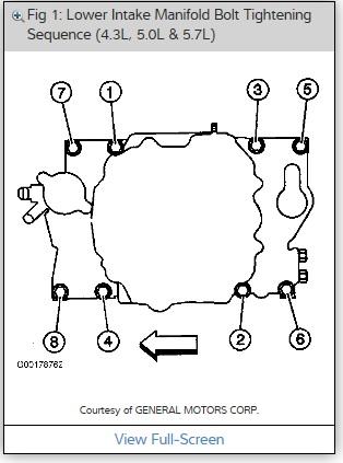

Do you know the intake torque specs on a 1998 chevy suburban?

Lower intake manifold, tighten in three steps. 1. 27 inch lbs, 2. 106 inch lbs, 3. 133 inch lbs
Follow the tightening sequence in picture.
