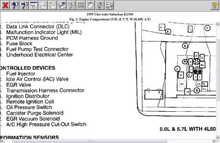

  • 75,992 POSTS
It has an HO2 sensor located at B see below
https://www.2carpros.com/forum/automotive_pictures/12900_ho2_1.jpg

SELLERSJAMES
  • 5 POSTS
I am assuming HO2 means Heated as O2 is not. I am almost positive it was a three wire sensor. I called about it to get a replacement and they argued with me at the parts store saying it has more than one, one pre cat and one post cat. I tried to tell them it has ONE. They told me it had one three wire and one four wire sensor. If I recall correctly it was the three wire sensor. I will recheck my connections as well as look into checking the bad ground and get back. Thanks for the help so far and hope something turns that friggin light off :lol:
Saturday, November 24th, 2007 AT 7:23 AM
PEAR69
  • 1,482 POSTS
Sorry if I mislead you earlier you are right, the 95's have one oxygen sensor. They are in fact three wire and they are heated. The color code is as follows Black=ground, pink or pink/white=ignition 12 volts, purple=the voltage output. The pink wire is the heater and the purple wire is the wire that talks to the computer. Test the purple wire for rapid fluctuating voltages from.2v to.9v. These color codes come from the chassy wiring and not nessesarily the wire on the sensor.
