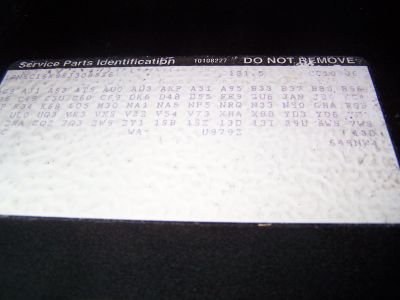

I am trying to replace my carpet because it has gotten so stained its beyond cleaning. I just do not know what carpet color I should buy? I want to find out the exact color of the previous carpet, but there are so many shades of grey. If there's a way you can find the factory grey shade they use, that would be very helpful!

First of all thank you so much for the donation. Lets start with what color you have first. If you could find your RPO code label we could figure that out. That's the label that tells your exterior and interior color stuff like that. Take a look in your glove box that's where I would suspect your is. IF you could get me a clear picture of the label or list the code's for me we can figure it out. Then we will work on getting you some new carpet.

https://www.2carpros.com/forum/automotive_pictures/534605_100_5410_1.jpg
its the best pic i could get for the angle, you can zoom in pretty well

I see a 13D on the label is there one?It says cloth light gray does that sound like your car?Let me know.

Yes I see 13D, and yes it is a full grey interior!

Try this website you will probably have to call them with your trim code which you now know. http://www.rockauto.com/ I haven't really shopped for a carpet kit so try that one and then you can do a google search to compare price's and your choice's.I would go with the precut instead of a roll so you will get the factory fit and finish.Let me know if you have anymore questions.Also thanks again for the donation and thank you for using 2carpros.
