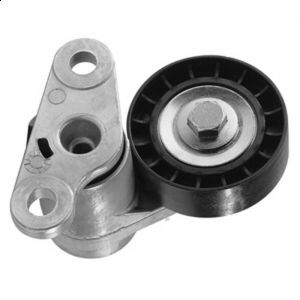

First, where is the tensioner and how do I go about loosening it so I can loosen the belt and remove the old alternator? Also, and more important, how do I re-tighten the tensioner and ensure I have the proper tension on the belt? So far it sounds like it is trial and error which sounds a bit scary.

The belt tensionier is spring operated automatic tensionier. Here is a pictire of one:
https://www.2carpros.com/forum/automotive_pictures/249084_belt_1.jpg
The pulley is on a pivot. You remove the tension by turning the pulley up or down based on what direction will eliminate tension from the belt.

Regarding the tensioner, I read all over the place that there is a bolt you need to loosen to loosen the belt and the same bolt is used to tighten the belt. Which bolt is that? And again, is it just trial and error to get the belt properly tensioned?

The tensionier is automatic and there is no bolt to loosten. It adjust itself via spring tension. As far as the alt. The OEM will need to work double time to charge additional batteries and to maintain the added load. The new on will be able to handle it. I suggested that it be properly regulated for your vehicle.
