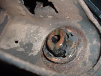

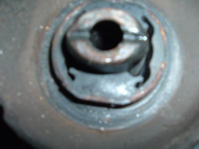

My truck listed above 2500HD has weird body mount bolts I need to remove to install nerf bars. They are sorta oblong with a hold in the center, they do not have a regular bolt head on them, see photos.
How do you remove these?

Wow, I can honestly say I never seen one like that. It appears to be missing a few parts. From the picture, it looks like there is a rataining clip holding it in place. Have you taken anything off?

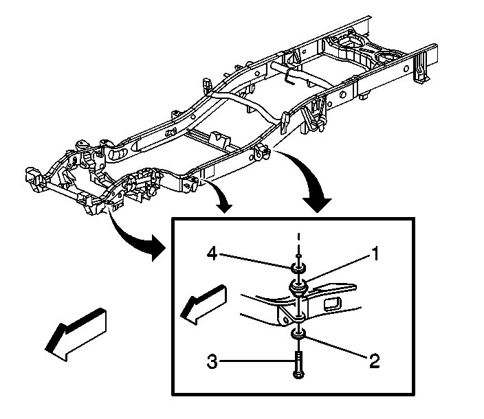

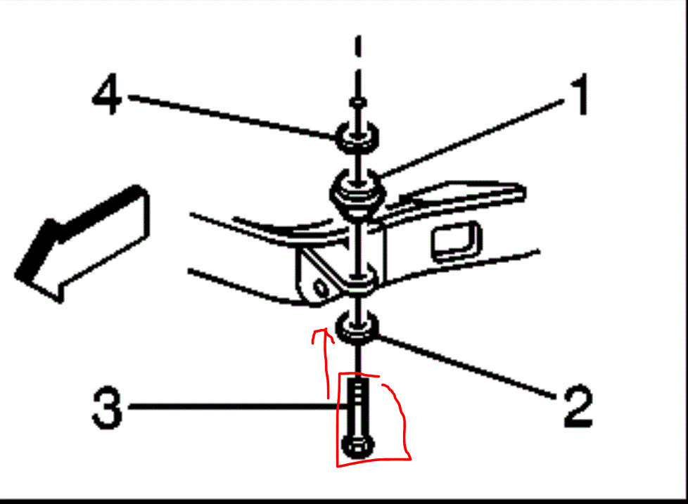

What you see in the above pic is not the bolt. There should be a bolt going into the opening with a rubber insulator and steel washer holding the body to the frame. See pic 1.
Here are the directions for replacement. Pics 2 and 3 correlate with the directions.

pic 2
4. Remove the body mount bolts.
