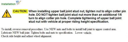

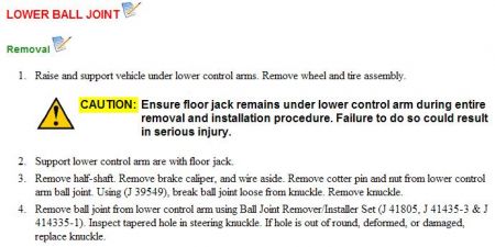

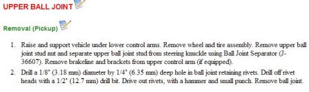

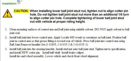

how hard is it to replace the upper and lower ball joints
Monday, August 17th, 2009 AT 8:20 PM
BLUELIGHTNIN6
MECHANIC
16,542 POSTS
Monday, August 17th, 2009 AT 11:52 PM
