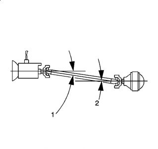

I would think that if it were imbalance, or untrue, the vibration would come and go. By that I mean, as it rotates it will reach a speed where it cancels, and reappears. I would think that would occur at higher propshaft speeds and kind of harmonically come and go, not at a launch from a stop. The service bulletin doesn't give any specifics on why it happens, and what changes when going from a 2pc to a 1pc. Does the vehicle fit the criteria of 2500/3500 Ext Cab long box, or Crew Cab short box, does this bulletin even apply. To be honest with you, if the vehicle fit the criteria, and was still under warranty, I would have no hesitation in performing the retrofit from 2pc to 1pc. I will offer you some info on the subject, it can be somewhat complex topic.

https://www.2carpros.com/forum/automotive_pictures/309872_182180_1.jpg
(1) Front Working Angle
(2) Rear Working Angle
Engineers design drivelines in order to compensate for the accelerations and decelerations in order to produce a smooth, constant flow of power, as listed below:
"Â The transmission drives the front yoke of the propeller shaft at a smooth and constant speed.
"Â The first U-joint causes the power to fluctuate twice for each revolution of the propeller shaft.
"Â The second U-joint, oriented 90 degrees from the first U-joint, causes the power to fluctuate opposite that of the first U-joint.
"Â As the first U-joint slows down, the second U-joint speeds up.
This design causes one U-joint to cancel out the effect of the other U-joint. The cancelled effects result in a smooth, constant power flow from the output yoke of the propeller shaft.
Second-order driveline vibrations occur when the cancellation becomes unequal between the front U-joint and the rear U-Joint.
The main objective of this section is to correct the conditions that interfere with the proper cancellation effect of the U-Joint. The most common condition, especially where the launch shudder is concerned, is incorrect driveline working angles. Other factors may aggravate the condition.
