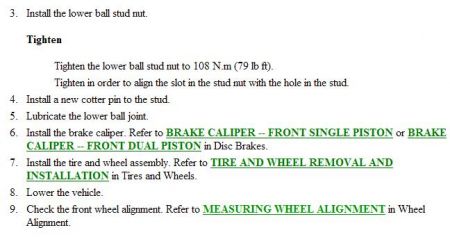

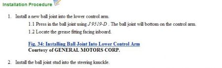

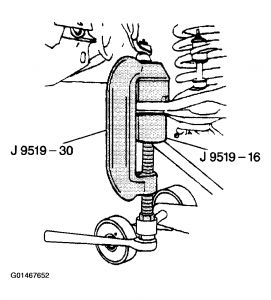

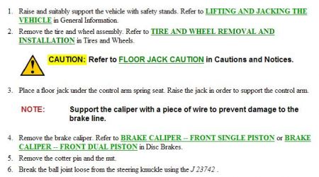

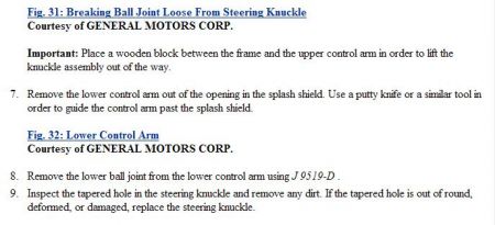

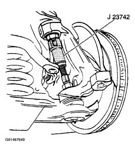

How do you replace the lower ball joints?

Hi there, ball joint information.

Hi there,
Pics of removal tool and installation tool.
