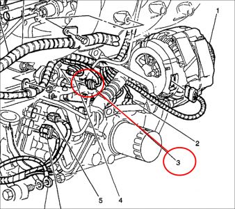

This question is for my dad. He owns a 1998 Chevy s-10. It has high mileage, and recently the Oil Pressure Gauge has been acting up. When started the Gauge essentially pegs out, going to 80 and just hanging there even when the engine is shut off. We are trying to find what this cause would be. Faulty Pressure switch or defunct Gauge?

Based off what you have said, I would replace the fuel pump oil pressure gauge sensor. I will attach the check if you would like but you will need a variable ohm tester that can adjust from 0 to 88 ohms.
It is item 3 on the pic
https://www.2carpros.com/forum/automotive_pictures/248015_78731497_1.jpg

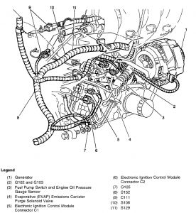

I have found the Oil Pressure Switch at autozone, but is their a difference in that and the engine oil pressure gauge sensor? I wasn't able to see that picture fully it was small.

Hello -
Here is a couple more pics. . .. . ...same one. . .. . .. . ...OEM part number is 12562571 and the AC Delco part number is D1819A
https://www.2carpros.com/forum/automotive_pictures/248015_Picture2_23.jpg
https://www.2carpros.com/forum/automotive_pictures/248015_Picture1_1.gif
