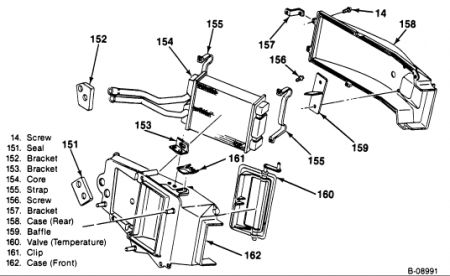

Drain coolant remove hoses then under pass. Side find cover remove screws then core retainer and core.

HEATER CORE REPLACEMENT
http://www.2carpros.com/forum/automotive_pictures/12900_chc1_1.jpg
http://www.2carpros.com/forum/automotive_pictures/12900_chc2_1.jpg
http://www.2carpros.com/forum/automotive_pictures/12900_chc3_1.jpg
REMOVE OR DISCONNECT
1.Coolant from the radiator.
2.Inlet and Outlet Hoses. Refer to "Heater Hose Replacement".
*Plug or cap the hoses to prevent spillage
3.Rear cover and screws.
4.Brackets.
5.Core.
INSTALL OR CONNECT
1.Core.
2.Brackets.
3.Rear cover and screws. TIGHTEN
*Screws to 3 Nm (27 in. lbs.).
4.Inlet and Outlet Hoses. Refer to "Heater Hose Replacement".
5.Coolant to the radiator.
