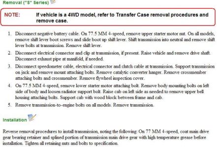

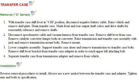

Simple question how do I drop the transsmition in my 1983 4X4 s10 blazer its a four speed manual trany. Thank you for your help.

https://www.2carpros.com/forum/automotive_pictures/261618_Noname2_535.jpg
https://www.2carpros.com/forum/automotive_pictures/261618_Noname_1692.jpg
