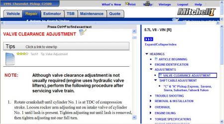

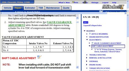

what are the torque specs for the rocker arms on a 96 3/4 ton chevy with a 350
Saturday, September 20th, 2008 AT 11:37 AM
MECHANIC
75,992 POSTS
Valves adjustment-see below
