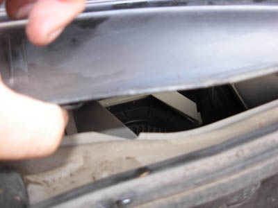

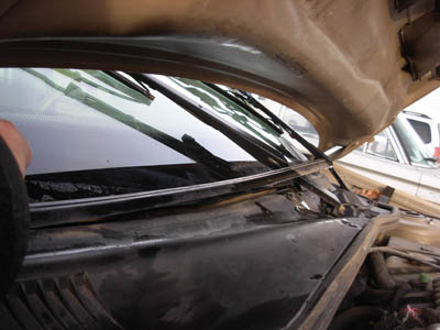

ROYCPP
The water isn't coming through the windshield. It's coming through the molding down below.
http://www.2carpros.com/forum/automotive_pictures/253778_Cowel_1.jpg
At the bottom of the windshield, there is a rubber piece that fits around the bottom of the glass. This piece lays on top of a plastic piece that is held down to the metal of the cowel by fastners. I pulled these fasteners and looked under the plastic piece. I saw the top of the fan.
http://www.2carpros.com/forum/automotive_pictures/253778_cowell_lifted_1.jpg
The problem I had was that the rubber modling was not laying on top of the plastic cover. I reglued the rubber to the windshield glass with silicon glue. I then glued it down to the plastic cover.
OK, maybe it was overkill, but my floor is dry and I was able to get the fan running. I now know where to find the fuse, and I know where the water is coming in.
