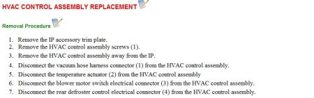

Please advise on how to clean or replace the ac control switch. goes off constantly, flickers, Had replaced once under warranty, Bad again, no more warranty, Can I take apart and clean ???
Any instructions would be greatly appreciated.

https://images.2carpros.com/forum/automotive_pictures/261618_Noname_2490.jpg

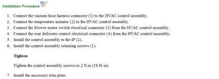

https://images.2carpros.com/forum/automotive_pictures/261618_Noname2_815.jpg
