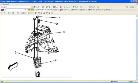

If the front brakes are good give this a try with both front wheels off the ground and the car on Jack stands. Put the car in neautral then put one hand on the front coil spring while spining the wheel as fast as you can with your other hand check both sides to compare with each other. If you have a bad bearing you should be able to feel it in the coil spring.

SATURNTECH9
  • 30,869 POSTS
http://www.2carpros.com/forum/automotive_pictures/416332_2000_chevy_malibu_coil_spring_1.jpg
Call out number 4 is the coil spring.
Tuesday, October 26th, 2010 AT 4:58 PM
VTCAROL50
  • 22 POSTS
DoI have this correct the coil spring is part of the strut assembly in the front? I hung the caliper on this with a bungy cord to keep it out of the way and not damage the brake line.

SATURNTECH9
  • 30,869 POSTS
Yes the coil spring a part of the strut but it's replaceable. It's hard to turn the caliper and rotor from side to side by hand and you have to remember to leave the steering unlocked. So is your noise gone now since you replace the rotor's and brake's?Glad to hear your learning to fix your car that's a good thing to learn you can save a lot of money that way.
