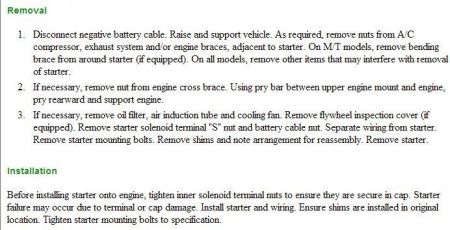

I would like to replace the starter myself if it isn't too difficult. How hard is it to get to this starter and remove it?
