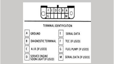

My code reader plug on the 95 lumina has only 1 wire hooked to it and no other visiable wires that go to it how many wire should there be or is there any other way to check I have a gm code reader plugs in to the port but nothing happens I think beacuse there is only 1 wire I think it is gray is someone could help I would be gratful thanks

https://www.2carpros.com/forum/automotive_pictures/170934_95_lumina_data_link_connector_1.jpg
If your datalink connector looks like the above picture, you can ground terminal B, turn the key on, no further, check engine lite goes to flashing, you count the flashes to get the codes.
If that is a hybrid connector for the crossover years, I can't help you. My info shows more than 1 wire going to the data link connector? There might be a decal under the hood that says if your fully compliant, obd1 or 2.

I was wroung about the 1 wire it has 2 wires. A & m that are the only 2 is there a way to check codes that way

That may require a special code reader?

I just picked up a 1995 Lumina (Manufactured 12/1994) and the SES light comes on after driving for 5-10 minutes. I went to do the "jumper" trick to get it to flash the codes. It has the OBD1 connector as pictured above but only has 2 wires going to the A & M positions. I just wanted to let you know that I also have that problem and I'm interested to see an answer on this one on how to get it to flash the codes, or if there is a special reader?
