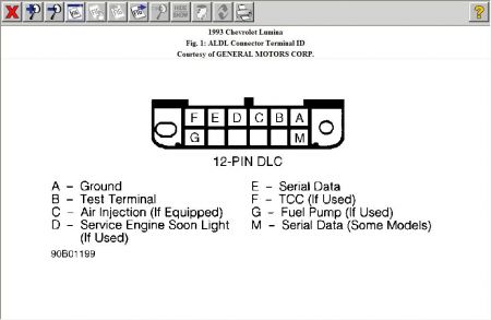

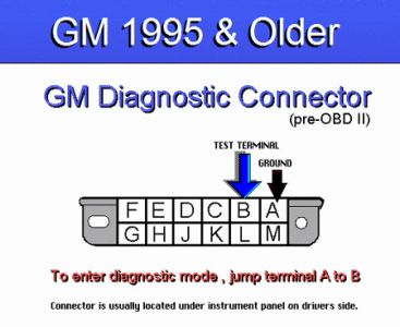

I changed the air idle controll valve & the coolent senser in the intake, started it up, had a really fast idle and after sometime, the service engine light came on. When I restart it, it will run really rough, then the sevice engine light comes on and it will smooth out to normal.
I have a hand held autoxray scanner, would like to pull the code but after taking the drivers side dash apart, there is no obd connecter no where to be found, what do you think of this?
Wednesday, August 20th, 2008 AT 4:08 PM
  • 75,992 POSTS
Its a 1993 has the OBD1 system-
https://www.2carpros.com/forum/automotive_pictures/12900_GM_ALCL_13.jpg
https://www.2carpros.com/forum/automotive_pictures/12900_alcl_1.jpg
Wednesday, August 20th, 2008 AT 5:33 PM
DNAPRORACING
  • 120 POSTS
The dc is located to the right of the steering wheel below the dash board. "To the left of the ash tray".
When was the last time the fuel filter was changed?
