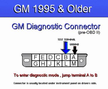

You need to have the computer scanned for code/s there's a problem within the engine management system causing the light to come on. Take it to Autozone its a free service to pull the code/s Or you can use a jumper wire on the A to B terminal on the DLC see below to flash the code/s. This is your starting point finding out what's wrong.
https://www.2carpros.com/forum/automotive_pictures/12900_GM_ALCL_42.jpg
