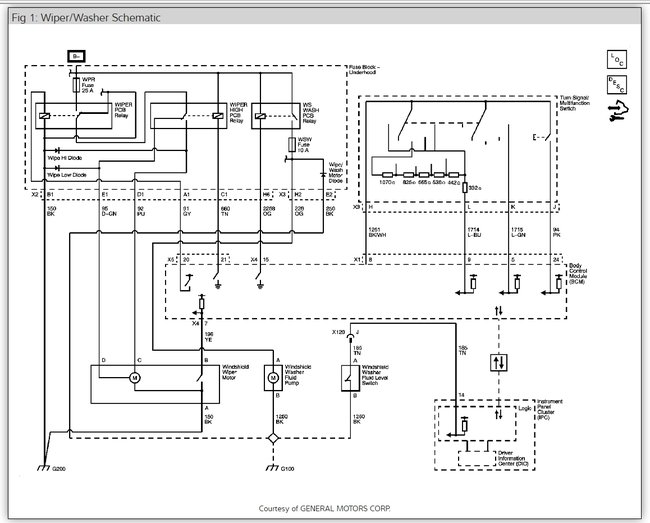

My windshield wipers don't work. They started acting intermittently worse and worse until they stopped completely.
Sunday, January 24th, 2010 AT 5:04 PM

Hey DANYIL,
This system has a wiper module that is located inside the BCM so lets hope its not that. Here is a wiring diagram and the wiper motor location.
Use a test light and see if the wiper motor is getting power. If so the motor is bad and needs replacement.
Please run some tests and get back to us so we can continue helping you.
Best, Ken

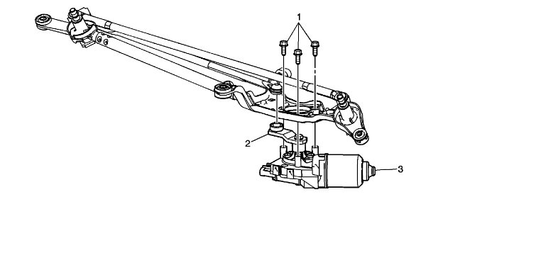

Wipers quit working, motor still works
they were erratically working and wouldn't shut off at times.
Honestly I'm a single Mom just layed off - I hate not paying you but if you could help me that would be great.
Thanks for considering.
Friday, December 16th, 2016 AT 4:33 PM (Merged)
WRENCHTECH
  • 20,761 POSTS
It sounds like the linkage came apart somehow. You will have to remove the motor to inspect the linkage and see what happened.
